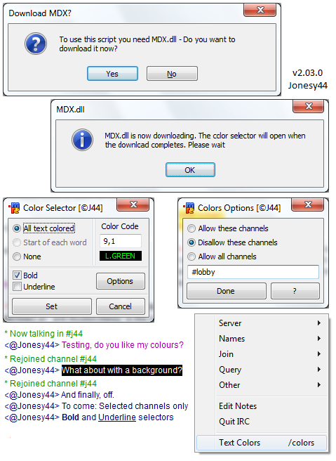

 Written by Jonesy44, Download alias structure by "FordLawnmower" & "Imk0tter"
; Version 2.05.0
; First Release: 17th August, 2008
; Updated: 8nd August, 2010
; MDX.dll found at: http://wfs.myartsonline.com/downloads/mdx.dll

alias Colors {
  if $MDX == -1 {
    if $input(To use this script you need MDX.dll - Do you want to download it now?,yq,Download MDX?) == $true { GetMDX }
  else { dialog $iif($dialog(colors),-v,-m) Colors Colors }
alias MDX { return $iif($isfile($qt(MDX.dll)),$shortfn($qt(MDX.dll)),-1) }
alias ColorsSecondary return $gettok(%colors.sel,2,44)

dialog ColorsOptions {
  title "Colors Options [©J44]"
  size -1 -1 100 60
  option dbu
  radio "Allow these channels", 101, 3 2 70 10
  radio "Disallow these channels", 102, 3 12 70 10
  radio "Allow all channels", 103, 3 22 70 10
  edit "", 201, 3 33 94 10
  button "Done", 301, 2 45 58 13
  button "?", 302, 62 45 36 13
on *:Dialog:ColorsOptions:*:*: {

; Download the MDX.dll file.
alias GetMDX {
  noop $input(MDX.dll is now downloading. The color selector will open when the download completes. Please wait,io,MDX.dll)
